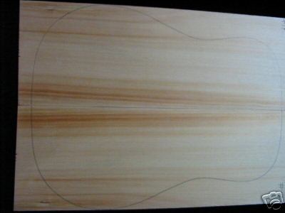

Shawn, thanks for the information. You thoroughly covered any questions I might have about using the pine. I actually bought this set on ebay because I liked the streaky coloration. It will be some time before I get a chance to work with it and will watch for any bleeding. For those not familiar with the wood, here is a picture.

You have some good points there Shawn.
